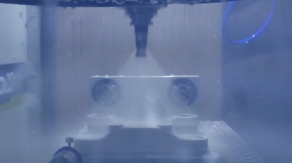

Through-Spindle Coolant Kit
Enhance tool life and machining performance with our new Through-Spindle Coolant Kit, designed to deliver coolant directly through the 1500MX’s spindle.
Key Benefits:
- Direct coolant delivery reduces heat buildup, prolonging tool life.
- Keeps tools clear of chips and debris, ensuring cleaner cuts and reduced chip buildup.
- Supports deeper drilling and milling operations, enabling faster production rates.
- Easily installs on your existing 1500MX with all necessary components included.
1500MX Through-Spindle Coolant
Technical Specifications:
- 3 HP, 220V single-phase motor
- Maximum outlet pressure: 435 PSI (30 BAR)
- Flow rate: 7.9 GPM (20 L/Min)
- Requires Flood Coolant Kit (PN 51567) for operation

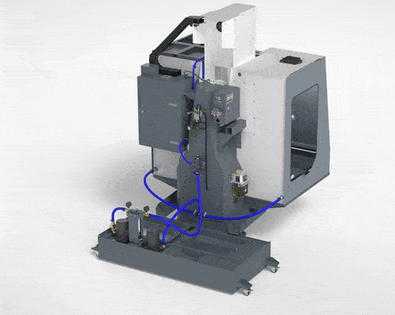

Mist Collector
Maintain a cleaner and safer workspace with the Tormach Mist Collector, designed to capture and filter out vaporized coolant and airborne particles.
Key Benefits:
- Effectively captures vaporized coolant, reducing airborne particles and potential health risks.
- Maximizes oil and mist particle filtration while recycling lubricants to reduce waste.
- Operates at just 65 dB with minimal vibration and long operational life.
- Easy push-button control and tool-less filter access, with washable stainless-steel filters.
1500MX Mist Collector
- 1/2 HP motor with 420 cfm airflow
- Compact dimensions: 395mm x 400mm x 650mm
- Requires 220V at 2.5A with a recommended 10A breaker
