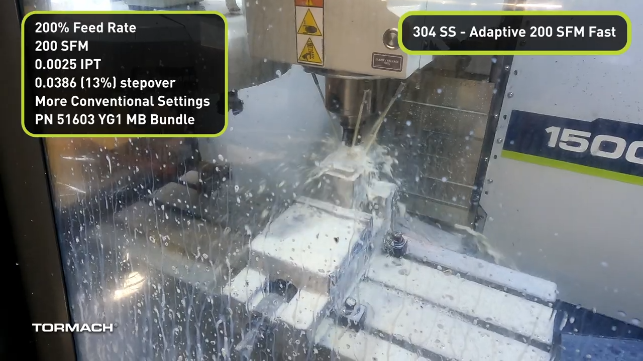

Next, Tom tested an adaptive roughing toolpath using a 5/16-inch four-flute carbide end mill from the Tormach High-Performance Tooling Kit for Steels. The initial default settings from the ToolPath PreTool application ran at an industry standard of 200 surface feet per minute (SFM) and a chip load of 0.00125 inches per tooth (IPT).
However, this setup resulted in a low spindle load of around 35 to 40 percent, indicating the 1500MX could push the cut harder. To optimize material removal, Tom increased the feed rate to 200 percent (0.0025 IPT), raising the spindle load without overloading the tool.

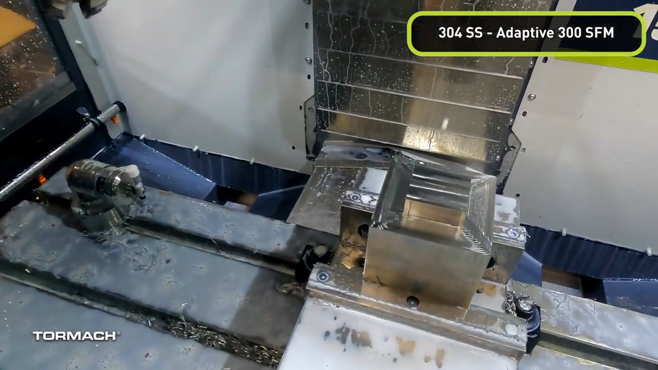

Despite some initial harmonics in one cutting direction, Tom further optimized by increasing the cutting speed to 300 SFM and a chip load of 0.004 IPT per tooth. This adjustment eliminated chatter and improved surface finish while bringing the spindle load to a more efficient 80 to 100 percent range.
Deep Cuts and High Spindle Loads
Tom then tested a deeper three-quarter-inch depth of cut, reducing the feed rate slightly to maintain cutting stability. This deeper cut increased spindle load to 110 to 115 percent, demonstrating the 1500MX’s ability to handle aggressive material removal.
Throughout testing, Tom monitored toolpath efficiency and spindle response, making real-time adjustments to feed rates and depths of cut. His final optimized toolpath achieved significantly higher material removal rates than industry-standard recommendations, without sacrificing tool life or surface quality.
