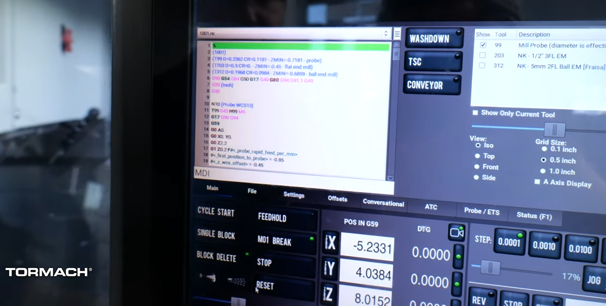

The CAM-driven probing macros are designed to be generic, meaning they can work with virtually any CAM software capable of inserting custom G-code. Users simply need to specify which features to probe, such as a top surface for Z, the inside of a bore for X and Y, or around a boss using three or four points.
Before calling a macro, a set of parameters is defined within the G-code to provide key information, such as the probing location, the work offset to update (like G54 or G55), and probing heights. Once the parameters are set, the corresponding macro is called to perform the probing routine and update the work offset automatically.
