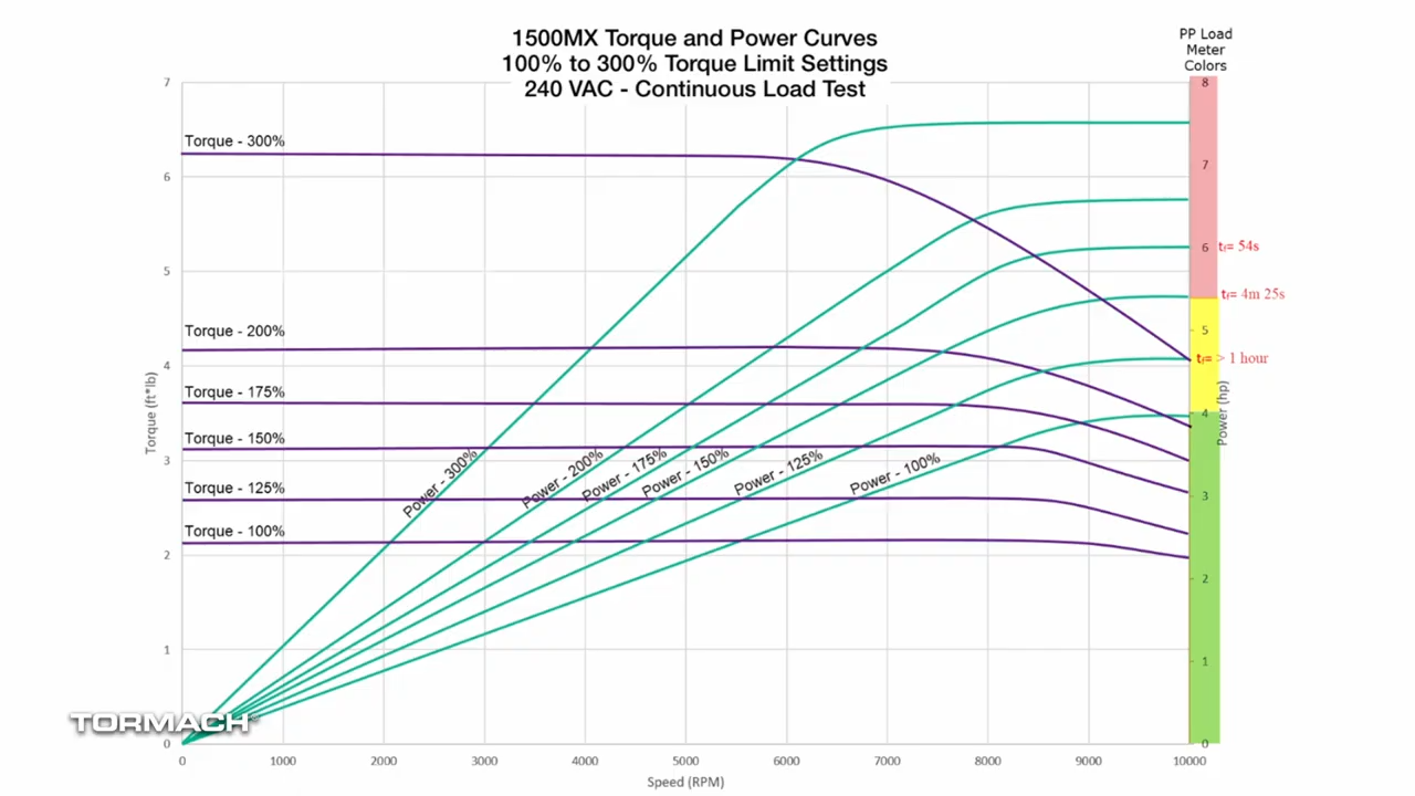

What Is a Torque Chart, and Why Does It Matter
A torque chart is a reference tool that provides information about a CNC machine’s horsepower, torque, and spindle load at different RPMs. It also indicates how long the machine can sustain a given load before it reaches its limits.
“I use a torque chart as early on in the programming process as I can,” Tom explains. “It helps me decide which tools I want to use, how to set up the machine, and which toolpaths I can leverage to optimize performance.”
The torque chart allows machinists to determine:
- How much material can be removed at a given speed and depth of cut
- The safest and most efficient spindle load levels
- When a machine is being pushed too hard and may require adjustments
Understanding Spindle Load Limits
One of the most important aspects of a torque chart is how it helps manage spindle load. Running a spindle at 100 percent load means the machine can sustain that power indefinitely. However, as you increase the load beyond 100 percent, the machine can only handle it for limited periods. For the 1500MX the torque chart give us the following information:
- 125 percent load – Can run for about an hour
- 150 percent load – Limited to a few minutes
- 175 percent load – Lasts under a minute
- 300 percent load – May only last for 30 seconds
Tom discovered this firsthand during his cut testing. “I pushed my machine to 300 percent spindle load just to see what would happen,” he says. “It was the most elegant failure I’ve ever seen. The machine simply stopped, went into fault mode, and didn’t damage the tool or part. I just had to press reset and jog the tool away from the part before adjusting my parameters.”

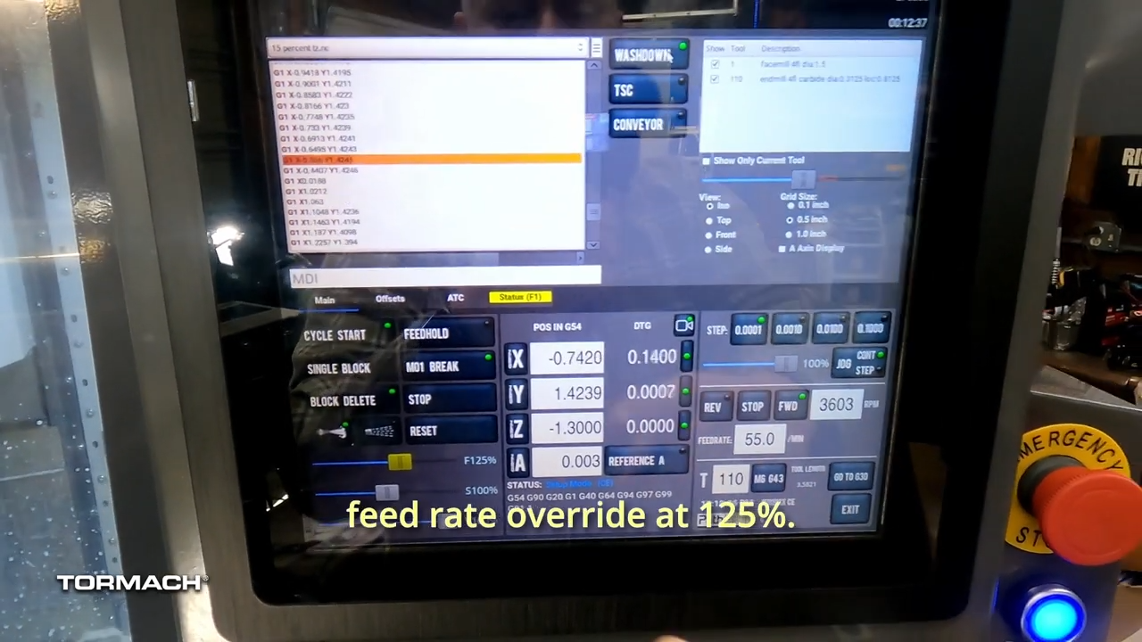

Managing Feed Rates and RPM
Another important factor in optimizing performance is balancing feed rate and RPM.
- If the spindle load is too high, reduce the feed rate or RPM
- If the machine is underloaded, increase the feed rate to maximize efficiency
“Imagine shoveling snow,” Tom says. “If you take tiny scoops as fast as possible, you’ll waste effort. If you take huge scoops, you’ll burn out quickly. The sweet spot is somewhere in the middle — removing as much as possible at a steady, sustainable pace.”

— Load Meter Feedback: The Tormach 1500MX displays a real-time load meter on the screen, allowing machinists to
make adjustments on the fly.
