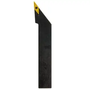

The Carbide Insert: VCGT 221 is a positive rake carbide lathe insert that is recommended for aluminum
Package of 10 VCGT 221 Carbide Turning Inserts. Positive Rake Insert with Chipbreaker. Recommended for Aluminum.
- Designation (ANSI/ISO): VCGT 221
- Shape: 35° Rhombus (V)
- Clearance Angle: 7° (C)
- Tolerance: Class G (G)
- Type: Single-Sided (T)
- Insert I.C.: 1/4 in. (2)
- Thickness: 0.125 in. (2)
- Corner Radius: 0.016 in. (1)
- Grade (ISO): N20
- Coating: Polished
- Chipbreaker: General Purpose
- Application: Aluminum
