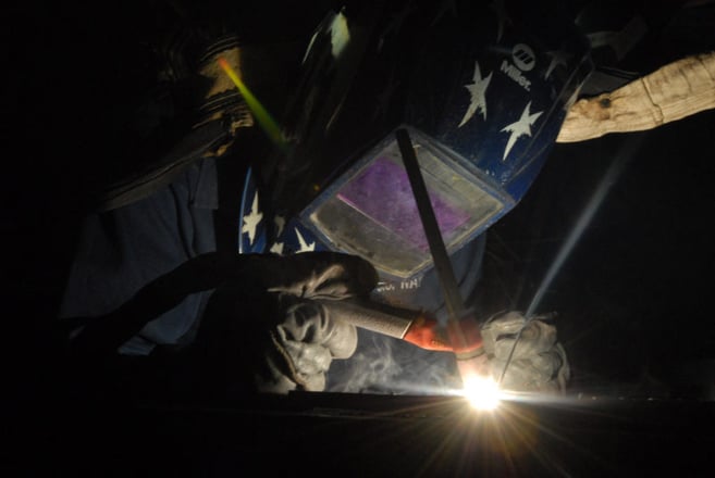

3 - Welding
While aluminum is softer and lighter, which makes it easier to handle, welding aluminum presents a whole different challenge. Some would argue that welding aluminum isn’t difficult, it’s just different. True, but still different enough to make this list. Aluminum joints solidify faster because it has a high thermal conductivity and melts at a much lower temperature than steel, which could be considered an advantage. But, aluminum is often covered with a “skin” of aluminum oxide, which melts at a much higher temperature than steel. Obviously, this can cause some challenges if proper preparation isn’t considered.
