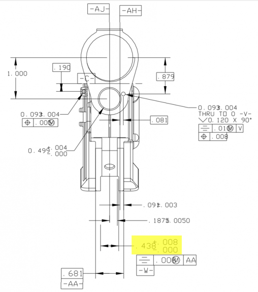

You probably already know this, but tolerances are important. If your product is a standalone part with only one component, tolerances may not be as important. Many machined parts, however, are destined to interface with another - whether part of a larger assembly or designed to be used with another product (such as an aftermarket car part). Tolerances are the key to making sure every part and piece of the assembly meshes together the way you intended. Tolerances separate good parts from great parts - so let’s take a look at a few types of fit. There are three important tolerance dimensions to be aware of. As an example, let’s take a look at the snippet of a drawing below, focusing on the highlighted dimension of .438” +.008” -0.000”:
•Basic Size (.438”) - the nominal or given dimension.
•Lower Deviation (-0.000”) - the difference between your Basic Size and the smallest allowed dimension (notice our part has no lower deviation, the smallest allowable dimension is .438”)
•Upper Deviation (+.008”) - the difference between your Basic Size and the largest allowed dimension (in our part, this is .008” meaning the largest allowable dimension is .446”).
When dealing with these tolerances, always think about what will be easiest to machine. In this example, trying to machine the feature spot on at .438” would cause more headaches than shooting for, say, .442”. Why is this? If your goal is to hit .438” every time, going even a little under that dimension means the part is out of tolerance and has to be scrapped. On the other hand, shooting for .442” cuts your allowable tolerance in half. Now you have wiggle room to miss your mark by .004” on either side of your goal and still be within tolerance.
