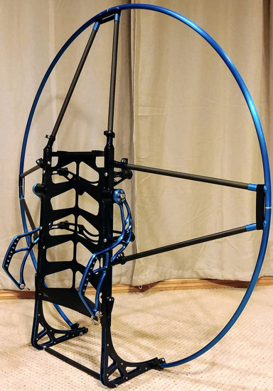

Zyuzin explains that there are quite a few CNC parts on his paramotor design. “In particular, the biggest challenge, and the reason I got a 4th axis on my Tormach, are these angled adapters that convert square tube sections to round.” Which makes the whole core frame that looks like the image below.

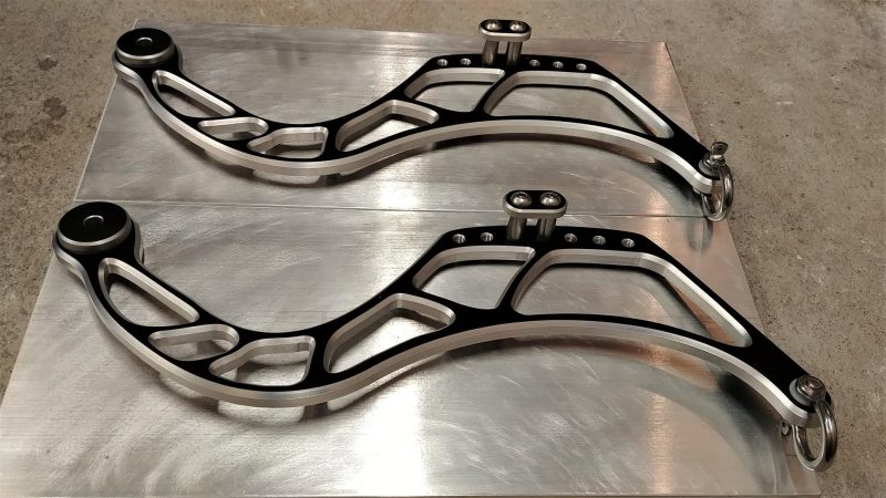

His parts have gotten a lot of attention in the Tormach Operators Group on Facebook. Particularly, the primary suspension arms, which are articulating arms that connect the machine to the wing and articulate to allow for weight-shift turning.

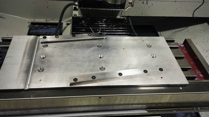

The suspension arms do not fit into my machine. The main reason I got the 1100M is that it's the closest in size to what I needed, but these arms are 18" long. When placed on the Tormach's 18" max travel table, they leave no room for the tool width. So, I had to design my fixturing and CAM programs diagonal and just barely made it work.”
“I had to get creative and machine a fixturing system that holds the parts in the mill diagonally,” Zyuzin continues. “The first op holds the full bar of stock (18” x 8” x 0.5") and before the finishing profile, I bolt it to existing holes below. I have since simplified and reworked the fixture plate a few times and it works great. It's nice and simple.”
With the final product being used to literally give people flight, he needed to make sure the parts were like any other aerospace component, strong and lightweight. “The shape of the primary suspension arms was actually determined using simulations and shape optimization algorithms, so the aesthetic element on those was actually ‘function over form,’ but the resulting organic shape helped drive the whole design.” He explains, “In terms of the whole unit, the biggest challenge was actually engineering the whole frame in a way that can be machined and fabricated, where parts can be interchangeable between the individual frames. The level of precision is very high, and any mistake in fixturing or machining will result in a frame that doesn't line up correctly.”

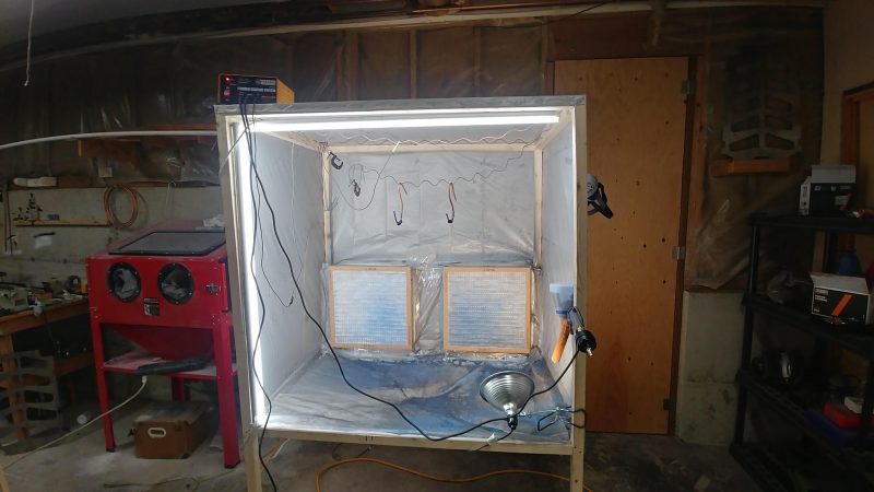

Zyuzin also uses a finishing process that is a bit under the radar for most folks. He does powder coating, but uses infrared lamps for the curing process. “I actually came up with the idea, but like most other good ideas, it has already been done before, so doing some research led me onto a few projects other people built that gave me confidence that it would work. I use an array of high-power paint curing lamps in an aluminum enclosure with a cover that can fit all of my parts in terms of size.”
“The whole bar of aluminum is powder-coated a matte black before machining and after the parts are fully machined I use a transparent candy color over the whole thing. The anodized look comes from having freshly machined surfaces and really good quality powder”
Using infrared lights for curing instead of traditional heating elements means that the air inside the enclosure doesn’t need to heat up. This leads to faster curing times, as well as less power consumption. “The whole cycle on smaller parts can be around 20 minutes from completely cold to fully-cured.” Zyuzin continues, “The reason is that the lights reflect on the aluminum enclosure but absorb into the powder itself which also heats up the aluminum. Another advantage is the oven/part size. An industrial oven big enough would cost several thousand dollars and would use a tremendous amount of power just to heat up. These lights swivel inside so I can cover parts of different sizes.”
